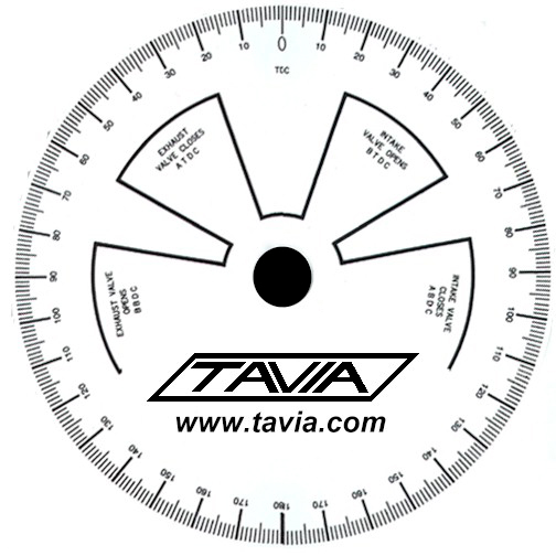

Be sure to degree in the camshaft when you intall it.  Stackups due to variances at the crankshaft keyway, crank timing gear keyway slot, camshaft keyway, and cam gear keyway slot can all add up to be significant amount thus requiring some adjustment during assembly to insure that the camshaft is installed in the desired position.
pcmenten
Posted 14 Years Ago
Supercharged (381 reputation)Supercharged (381 reputation)Supercharged (381 reputation)Supercharged (381 reputation)Supercharged (381 reputation)Supercharged (381 reputation)Supercharged (381 reputation)Supercharged (381 reputation)Supercharged (381 reputation)
Posts: 375, Visits: 1.1K
You'll need a degree wheel.
