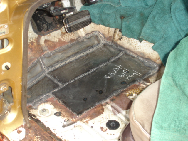

I picked up a 4'x4' sheet of 16 gauge CR - price was ok at $45.  The floor came out really well.  I included a picture for anyone interested in trying that method.  I just need to grind down the welds, paint it, and buy a gas pedal...  I only used about a 6" x 4' section of the sheet, but I'll probably use some of the remaining steel to make a hood scoop.  Smile

Geez, looks great! What was all the worry about? Smile Chuck in NH
