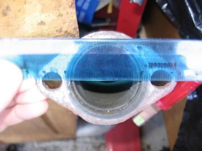

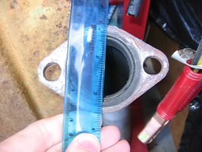

I have a crossover pipe that I cut the flanges off but the ID is about 1 5/8" which can be opened up. What bothers me is the flange surface is smaller than the gasket and may leak.

Charlie, take a look at this picture.

It looks like there are at least 2 sizes of crossover pipe.
The one I used had a 1 7/8" pipe. The flanges are about 2 1/2" by 3 3/4"
Red's makes car headers which mount to stock pipes. Maybe they'll have flanges.
