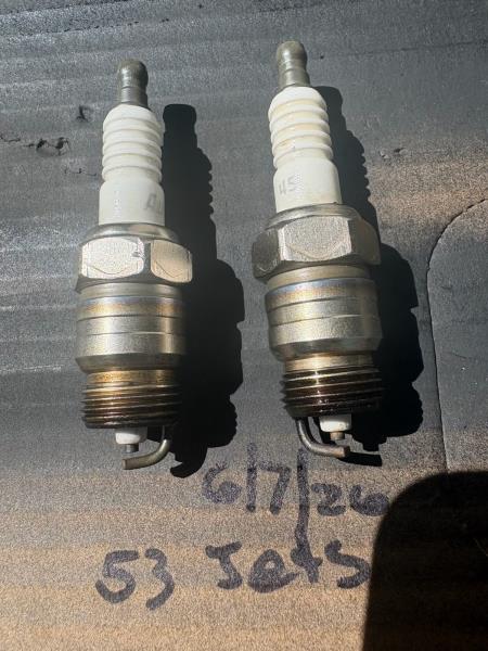

I have owned this car for close to 3 years.  I do not know any history regarding a rebuild.  It actually runs very good right now.  When I had the heads off to check the head gasket orientation the pistons did not have any stampings indicating they were over bored.  The head gaskets were the old style metal type, so there were no tabs to identify if they were installed correctly,which is why I removed the heads.
I drive this car on the highway a lot....... speeds of 75-85 are common.  I am talking about this speed (engine RPM's 3000-3500) for 30/45 minutes as I am trying to optimize the cooling system with the air conditioning on.   My test run also is "up hill",which is a constant grade for a couple of miles.  When I turn around to return home, now going down grade the car runs 3-5 degrees cooler (digital gauge with sensor installed in the stock/head location.
Plugs are white with little tan......  Would a cold engine compression test be of any value?  Once the exhaust manifolds are warm it's difficult to screw in the hose without burning my hands for the compression gauge.   I always thought a warm engine would give more accurate compression readings,  Is there a better tool or some sort of adapter the would be more user friendly on my engine (stock exhaust manifolds)?
Pictures of plugs take  a couple of months ago, very typical.  These are actually one step colder plugs I bought just to try them. No noticeable smoke out of exhaust or breather (with the PCV valve wouldn't the breather be more of an "input" to the system?

I do most of my compression checks on engines that are cool as doing them on hot engines can damage the gauge.  I change the oil on my ’55 Customline at 2000 mile intervals and while it’s dark indicating that it is time for an oil and filter change, there’s no indication on the dip stick of any oil being used.  The 272 engine has well over 200K miles on it since it was last opened up for any work and still runs fine.
Most of my driving takes place with the engine running at 2500 rpm or less as it is a standard shift overdrive car.  About thirty years ago I changed out the original 3.89:1 rear gears to a set of 3.56:1 rear gears which made the car happier at the 75 mph highway speeds.  I suspect some of your oil usage occurs as a result of running in excess of 3000 rpm for extended periods of time assuming the loss is not related to any oil leakage.  Based on the pictures of the two spark plugs, your engine would appear to be fine but a compression test and examining all eight spark plugs would help to alleviate any fears about the engine needing some immediate attention.  When performing the compression test, do so with the throttle opened up fully to ensure a full charge of air to the cylinders.

All eight plus look like the two in the picture.   I will make sure to change the oil at 2,000 mile intervals.
