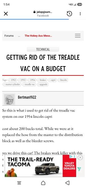

Looks good, pricey. I'd like to get one in a 7" booster tho. I saw a post on HAMB from a guy who put a 60-66 falcon dual mc and 7" booster an a 54. Had to do some mods on the linkage. Had pics and a pretty good explanation of how he did it. Under $200 for all including the linkage rod extension kit. His was a single mc but a dual isn't a whole lot more. Even eith the 7" it looked a little tight, could still access the valve cover. I'd share it here if I knew how.
Thanks for all the insight. I might have posted a screenshot of the forum post.

Found it. That sure looked like the ticket to me. Good work on research.
