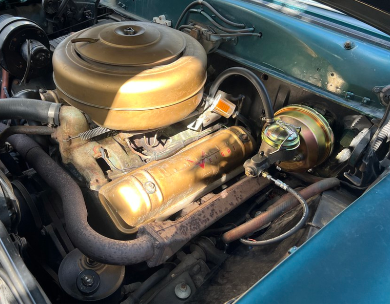

I went and looked at ABS since I’ve used them before. They come up with 9” booster, etc. Look close at the picture of the unit. It appears it might have a bell crank sort of device on the pedal rod, transferring the motion to the mast cylinder. That’s a good sign for a treadle vac replacement, as that linkage is part of the problem.
It’s been a while since I’ve looked at a Capri, but it seems the treadle vac was down low, a very busy area with the steering column and exhaust. But it might be worth a call to these guys. Ask questions. My recollection is that there’s not much room for a 9” booster, even up higher, before you hit the valve cover on the Lincoln engine. But ABS will probably be up front.

K, what’s your take on the picture of the booster?
https://abspowerbrake.com/products/lincoln-capri

Looks good, pricey. I'd like to get one in a 7" booster tho. I saw a post on HAMB from a guy who put a 60-66 falcon dual mc and 7" booster an a 54. Had to do some mods on the linkage. Had pics and a pretty good explanation of how he did it. Under $200 for all including the linkage rod extension kit. His was a single mc but a dual isn't a whole lot more. Even eith the 7" it looked a little tight, could still access the valve cover. I'd share it here if I knew how.
Thanks for all the insight. I might have posted a screenshot of the forum post.

"K, what’s your take on the picture of the booster?
https://abspowerbrake.com/prod...
That one is correct. A 7in DUAL will not profuse ... ??? ... PROFUSE ???
... produce (result) ... (3rd grade education)
... enough line pressure if going front disc for that heavy of a car (IMO). The mounting bracket design will allow the BOOSTER/MC to clear the exhaust manifold.
As you say, the OEM drum brakes should be good on a stock LINC (IMO).
