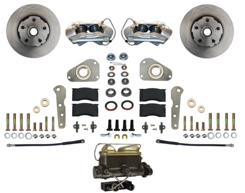

The MC from WILWOOD is going to be a custom piece.
https://www.wilwood.com/MasterCylinders/MasterCylinderLanding
The kit from LEED's is going to be period correct OEM appearing.

A DRUM/DRUM MC will not work on a DISC/DRUM setup.
It will not generate enough line pressure to energize the calipers properly.
WILWOOD is eye-candy to me, though quality is exceptional.
And don't fall for the cheese-grater rotors for the street. Strictly eye-candy and $$$.
