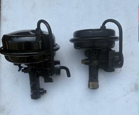

After installing the kit, I thought the discs needed more pedal pressure to stop comfortably.  I installed a Midland C490 booster (recommended by Hills) and it improved the stopping power eliminating the need for the heavy leg pressure required for the "final" stop.
