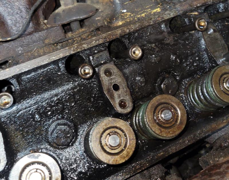

'57 F-100 272. Truck sat for 20+ years. Engine is free but wanted to make sure top end is oiling before firing up. Removed distributor and spun pump with a drill, 42-44 psi with test gauge. Passengers head gets oil, drivers does not.
Long drill bit down hole where rocker stand would be and no sludge in that so it could be in that sideways port or in block port.
Is there a chance the early manufactured engine has a drilled cam instead of a slotted journal and ports aren't quite lined up until engine is bumped a few degrees?
Possible clean passenger oil passage so oil is taking the easier route?
Penetrant seems to go somewhere when sprayed into drivers side oil port in head so I dont think its completely plugged or there is an issue with the head gasket.
Any good way to plug passenger side and force oil out drivers side or should I turn engine a few degrees and try until I get oil out of the drivers side.
Sorry for the long winded post. Any input would be appreciated.

current post with a cool way to try to clear galley. if you pour something down that hole does it drain quickly or fill up and slowly drain?

Was slow. Appears I have a truck that was early enough to have a cross drilled cam. Turned crank about 15° and getting oil to drivers head now.

along the way the cam was changed.people are still finding them in recent engines today.
Posted 4 Months Ago
Keep in mind that the 1963 & 1964 Ford pickup and truck engines went back to using the cross-drilled camshafts instead of the grooved journal camshafts that were being used prior to that. I do still come across a large number of the cross drilled camshafts in core engines.  Many of these are still in the ‘63/64 engines but others are in earlier model engines that were rebuilt by the major rebuilders.
