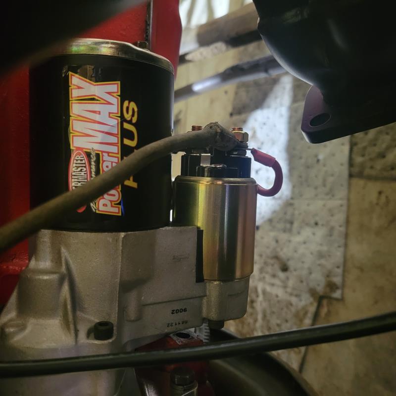

So I got a 9002 and installed it, and it's giving me the same issue. It's not grabbing the flywheel. Could this be a toothcount issue? Or am I doing something wrong. I tried turn the motor over a little at a time to try and get the starter teeth to lock in and turn it over, but i got nothing. Sad

Are you sure you have adequate grounding? might have enough to pull the Bendix in but as soon as it tries to move the flywheel it runs out of pathway for the juice.

am I sure?  No, I'm never sure when it comes to this beastie.  However, I'll give it a shot.   I'm assuming Engine to body and Engine to Frame?  I'll check to make sure all contacts are clean and metal on metal.
And just to confirm, the only wire going to the starter should be the cable from the starter relay, correct?

starting issues were the bane of my existence in high school. a bunch of ways to test but had i done voltage drop i would have better understood at that time. all these test are done while cranking the engine, a charger on the battery would be good if you have one available. start off with measuring voltage at battery, above 10.8v is good if below 9.5v charge battery or try another battery if possible. could use jumpers from a running car if needed. next put voltmeter on starter + lug and on starter case, should be 9v+, 8s might be ok. next measure battery negative post to starter case, and starter + lug to battery + post. need to see below 1v each, specs usually under .5v. i had originally used available voltage when i wasnt as experienced and i confused myself. found out later i had a nearly 5 volt drop on ground side after replaceing batteries, positive cable, solenoid. I found a cheap mini starter but its taking a lot to install it.
good luck and update.
