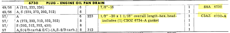

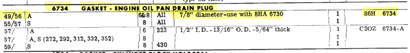

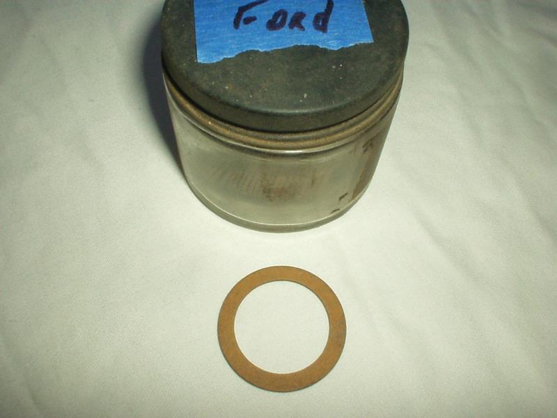

If the pan and plug are original to the OEM engine, the thread size should be 7/8" and the correct washer (crush) should be copper. The drain plug threads (and possibly pan threads nay be stretched.
Try a new washer first and if they doesn't stop it find a new drain plug and maybe chase the pan threads,
http://forums.y-blocksforever.com/uploads/images/532e82a4-8910-4e3f-9fe6-8062.png
http://forums.y-blocksforever.com/uploads/images/4e2edd3f-06b4-4299-b230-98bd.png
http://forums.y-blocksforever.com/uploads/images/826369af-a153-49b1-90a2-1d5f.png
