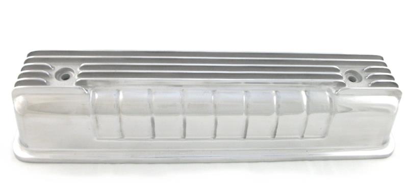

I just bought a pair of the Spotlite Kustoms aluminum valve covers (the ones that look like the OEM steel covers but with fins).
http://forums.y-blocksforever.com/uploads/images/65a810ea-4785-473c-8a59-9e5.jpeg
Didn't take long to realize the stud holes are too small for the OEM grommets. The lower portion of the grommet that sits inside the stud hole is about .100" larger than the hole. Figured I could just shave that part off and try it, but even after that the remaining portion of the grommet is still too fat to seat correctly in the recessed area around the stud hole.
Wondering if anyone else has run into this, and what you did to make it work.

Looking at the valve covers, it looks like the space for the flat washers is too small besides the problem with the grommets.
Like the poster, I never knew there were two sizes.  I have the TBird covers on both of my cars and the grommets I have (and have a lot of extras) seem all the same size,.  They also fit the valley cover.  I have a couple of tin sets around so I will try them on those.
CASCO  only lists one grommet, but Hill's list two sizes, one for steel and the other for aluminum .  In t Hill's and Concours , , the listing for the steel ones are also for the valley cover while the listing for the aluminum ones are for the rocker covers only.

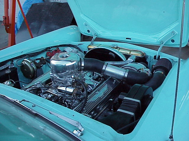

Still waiting for the new grommets to show up so I asked Tim McMaster about his experience with these covers since he recently posted some pics of a recent build using them. He said that instead of grommets he used umbrella valve stem seals with a 5/16" flat washer. Works very nicely.

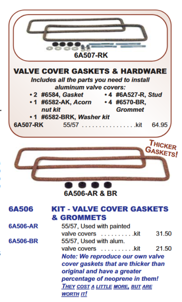

http://forums.y-blocksforever.com/uploads/images/4534e8cc-deef-4f21-95b8-2d36.png

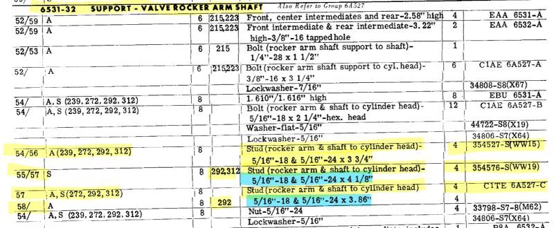

The mounting studs for the ALUM CVR  also longer -
http://forums.y-blocksforever.com/uploads/images/49970219-e2fb-48ab-a331-db00.png
Posted 8 Months Ago
On the Spotlite valve covers, I have used a thick O ring topped off with a smaller O.D. flat washer while using the original acorn hold down nuts.
Posted 8 Months Ago
Posts: 2.0K, Visits: 306.7K
What would be interesting is if the aftermarket hold-down holes were machined the same as OEM BIRD.
While there two grommets released (OEM) , will the OEM BIRD grommet seal the aftermarket rocker cover?
