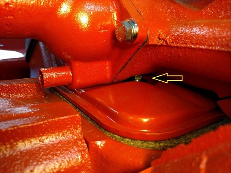

Regardless of what valley cover is used, make sure the grommet does not make the front valley cover bolt sit so high that the intake manifold sits on the bolt head.  Bad result is a manifold or water leak.  Worst result if breaking off the front ears of the intake manifold.  Check by setting the intake on the heads without a gasket and see is a feeler gauge or a thin piece of cardboard will pass between the bolt head and the manifold.
By Marc - 8 Months Ago
Good advice John. That's always something that needs to be verified.

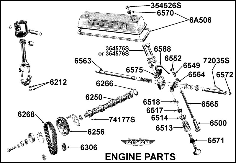

By KULTULZ - 8 Months Ago
http://forums.y-blocksforever.com/uploads/images/4534e8cc-deef-4f21-95b8-2d36.png
The mounting studs for the ALUM CVR  also longer -
http://forums.y-blocksforever.com/uploads/images/49970219-e2fb-48ab-a331-db00.png
http://forums.y-blocksforever.com/uploads/images/1e6abefe-0d25-43e2-9a49-7f0e.jpg
By 55blacktie - 8 Months Ago
Tight fit. I guess I never really noticed. Things are often overlooked, until they become a problem.

Definitely a good idea to check your clearance between the intake and the forward valley cover bolt. I just installed a Mummert intake and realized it was making contact with the forward bolt head. Ended up grinding the bolt head down just a bit to gain some clearance.

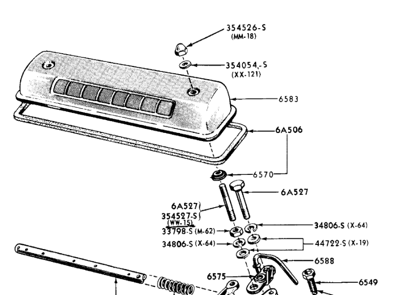

Here is my thought -
There were two styles of grommets for the FYB. One was original assembly and did not have the integral washer (B4A 6570-A). The other, a 1959 model year parts superscession, had the integral metal washer (B9A 6570-A).
If one were to take the early style and reduce the grommet diameter and reduce the O.D. using the proper size hole punch (used to make gaskets from gasket paper), it should yield a proper service part.
This would seal the opening and allow the brite finish washer and acorn nut usage for proper appearance (to me anyways).
It is the little details that set one engine apart from another.

Do you notice any difference(s) between these two parts illustrations?
http://forums.y-blocksforever.com/uploads/images/51295e1e-7bfc-4353-ac49-614f.png
http://forums.y-blocksforever.com/uploads/images/a1ca6180-4a9e-4da7-b360-788b.png

What I meant for his reasoning is he must have come across the 1st engineering ILL and thought the grommet went underneath the rocker cover.
It was a misprint. The 2nd ILL is correct.
