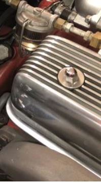

Blacktie, exactly. A washer and acorn nut go on top. Seems like a lot of fiddling around to avoid a ham handed mechanic. Maybe Doc sold a lot of engines to them. Ive always run cast valve covers and been careful about tightening them on any engine. And a lot of the cores I’ve torn down showed warped covers and leaking gaskets. But I’ve not had that problem.

Here is my thought -
There were two styles of grommets for the FYB. One was original assembly and did not have the integral washer (B4A 6570-A). The other, a 1959 model year parts superscession, had the integral metal washer (B9A 6570-A).
If one were to take the early style and reduce the grommet diameter and reduce the O.D. using the proper size hole punch (used to make gaskets from gasket paper), it should yield a proper service part.
This would seal the opening and allow the brite finish washer and acorn nut usage for proper appearance (to me anyways).
It is the little details that set one engine apart from another.

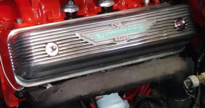

That is a nicely detailed engine compartment.
Any chance of a full photo?
Posted 7 Months Ago
Posts: 1.9K, Visits: 195.0K
Thanks K
There’s been a couple differences versions. One of the original build, 320 stoker with the Paxton supercharger. Very early digital camera, the color is off.
The other is the current version with the Mummert heads and EFI. The smaller chambers increased the static ratio to 10.7, so the supercharger had to go. Replaced with a/c.
