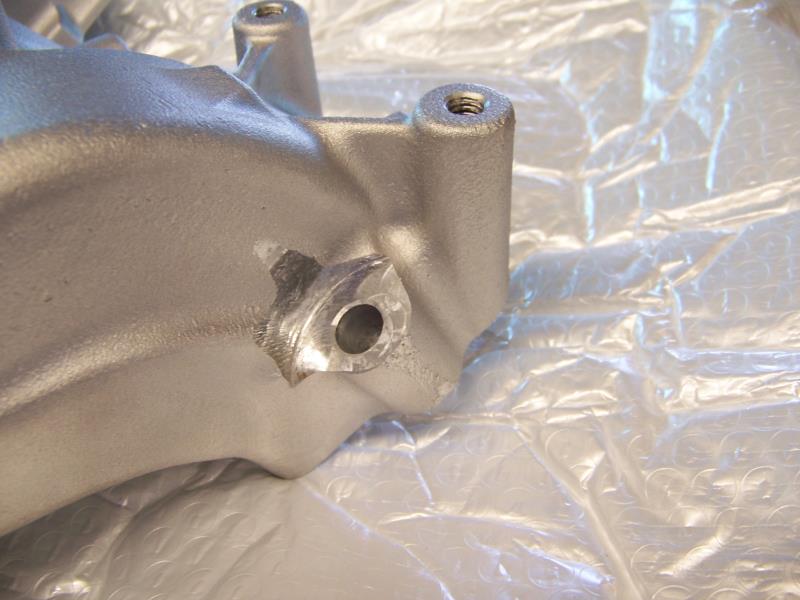

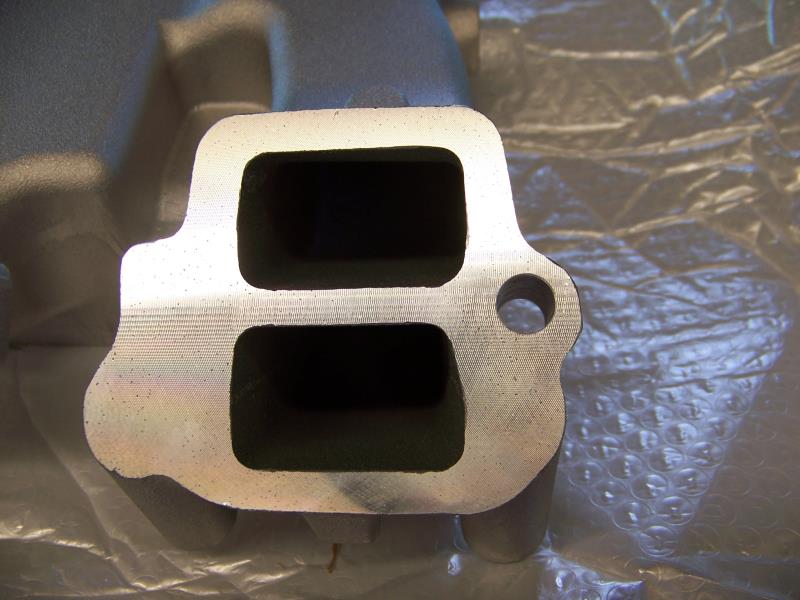

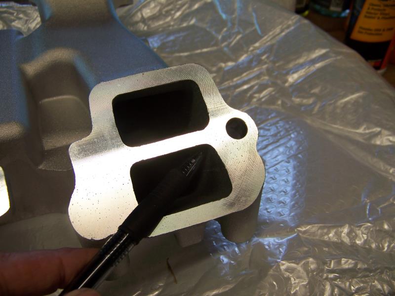

Cliff have you come across core shift that could be problematic, or is it just more metal inside to remove?
Seth
Cliff
Posted 7 Months Ago
Posts: 908, Visits: 14.0K
Yes a little, but nothing that I could not fix, most problems is with the rear ports, they get thin at the bolt hole. These manifolds are cheap, they are not better than http://forums.y-blocksforever.com/uploads/images/7dfd8daf-a9c8-4d6e-b9c5-9f5c.jpghttp://forums.y-blocksforever.com/uploads/images/a6ad0199-8603-48b2-9e8b-a663.jpghttp://forums.y-blocksforever.com/uploads/images/ea2c7fbe-0d37-4d40-94c5-3ae9.jpgstock, I spend about 1 1/2 hours on each one.

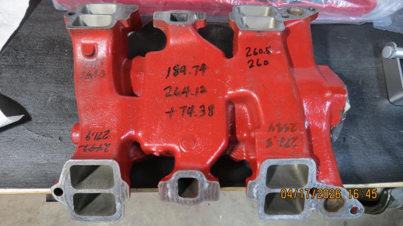

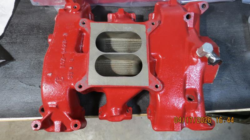

I ported my ECZ-B iron intake for testing for the 304CI Y that Ted and I took to EMC.  We tested several intakes and 3 sets of heads before finalizing the engine for EMC.  The ECZ--B made 437 hp and my ported Mummert dual plane made 454 hp.  It took a lot of time, effort to get the ECZ-B to respond to porting but can be made quite good.  As cast it only flows ~189 cfm and the new aluminum intake that I flowed for Ted flows ~184 cfm IIRC.  Here are a couple of pictures of the ECZ-B after port work.  Joe-JDChttp://forums.y-blocksforever.com/uploads/images/c8ac3f0f-1598-4392-b4b4-f9b2.jpghttp://forums.y-blocksforever.com/uploads/images/f02fb5a9-c646-4e58-ba54-6b80.jpg

Hi Joe, you always do a better job that anyone else can. what flow bench do you use? mine is a JKM 600 (old)

Joe, how much of an improvement have you seen when the ECZ-B intake carburetor base/plenum has been opened up to two ovals, runners blended into the plenum, and removal of any casting flash/irregularities but no extensive porting? Surely you've tested in stages to determine what modifications return the greatest improvement.
Just looking at John Muumert's Y-block Porting chart, the stock ECZ-B intake will outflow stock ECZ-G heads. However, once the heads have been worked on, the stock, non-ported ECZ-B intake could be a restriction.
