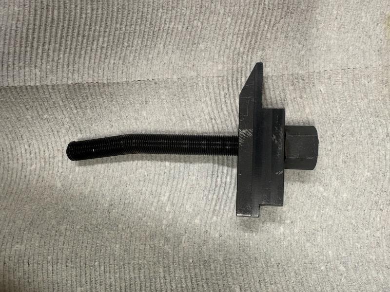

I tried the correct tool from Hills Thunderbird.   I was using the crank shaft bolt for a contact point for the tool to press against.  The end of the tool keeps walking off the crank bolt, at one point the tool bent (see picture below).   I was able to straighten it with heat.   Now I inserted the tool directly into the crank, which is what Hill's recommended.  I ground off the treads on the end of the tool to keep them from galling the threads on the crank.
I am using a breaker bar and socket to turn the tool.   The pulley doesn't want to budge.  I am going to try an impact wrench, maybe the jolts will help it break free????    To do this I have to move the AC condenser for the impact wrench to fit.

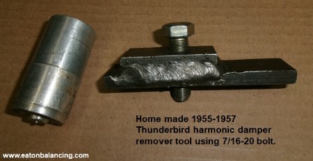

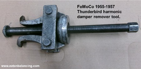

An impact wrench typically helps with the damper removal process.  Here are pictures of both a homemade damper removal tool which requires a spacer to help with using the shorter bolt and also the factory damper removal tool for the Thunderbird dampers.

When a part of the tool bends out of shape the tool cannot be removed from the pulley and must be cut out (I'm still working on that).   I ordered a new tool It looks like this, the end swivels, last one did not have this feature.   If this one doesn't work should I try heat????

I straightened  it as best I could.   I had to heat it up a few times.   The shaft bent again (maybe the heat weakened the metal?)  that's why I ordered the tool from Casco.   With the shaft bent the puller cannot be removed from the pulley......   I have to figure out a way to cut it without any collateral damage.    New Tool should be here tomorrow
