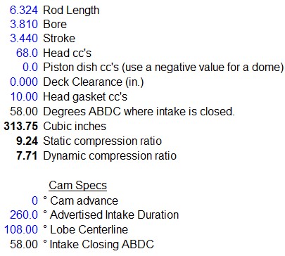

Daniel.  While you do not give the particulars on how much bore and stroke increase you have, it’s difficult to get in trouble with the compression ratio on the Ford Y when using iron heads.  For the math, I used a 0.060” over bore, a 312 crankshaft with the pistons at zero deck, and the E4 camshaft installed straight up (zero advance or retard).  You said a 0.005” mill on the heads, so I used 68cc for the combustion chamber value without any other information to go by.
http://forums.y-blocksforever.com/uploads/images/433a326e-0c01-4a63-a200-05f4.jpg
With these values, I do not see any issues at all with your basic combination.  The engine may see a slight hesitation right off of idle with the camshaft at 108° intake lobe centerline depending upon the carburetor.  Loosening up the lash some more can help with that.  Carb adjustments would include a richer idle circuit and potentially more pump shot from the accelerator pump.
