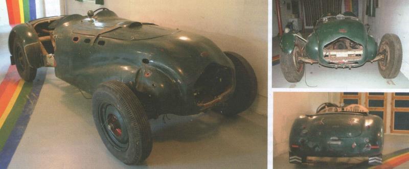

Any pics of the rest of the Allard?  Sounds cool.

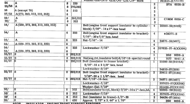

When looking at the Ford, Mercury, and truck parts catalogs, be sure to look at the other engine families and not just the Y.  The FE and M-E-L engines shared the same block motor mount bolt patterns as the Y.  With this in mind, also look at the FE and the M-E-L motor mounts.  In looking at the 55/56 Mercury catalog, the Y-Block motor mounts (basic part number 6038) for 1954-1955 are different than what’s listed for the Ford and Thunderbird vehicles.  Here’s the excerpt from the 1959 Ford catalog.

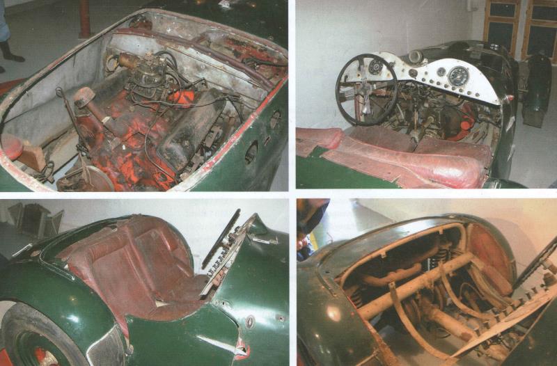

http://forums.y-blocksforever.com/uploads/images/2009c14f-f0c1-46fc-9083-350d.jpghttp://forums.y-blocksforever.com/uploads/images/adbb73c6-0245-4817-ae2d-097d.jpg
This is about 20 years ago, before I inherited the project from my father.

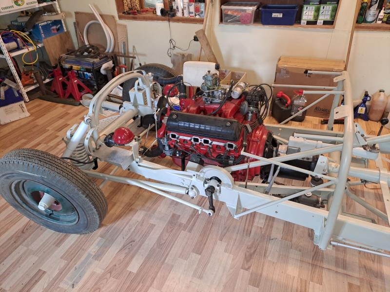

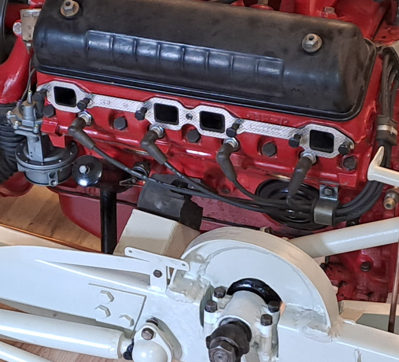

http://forums.y-blocksforever.com/uploads/images/371a3bb8-b339-4be1-8941-2833.jpg
This is a recent picture. Its a slow moving process...

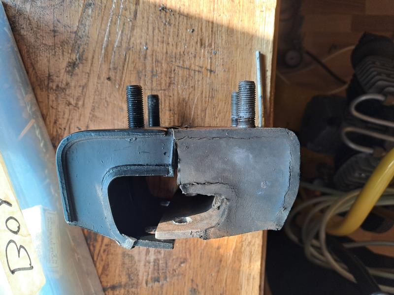

My original: The offset of the hole is 46 mm, the height is 66 mm
http://forums.y-blocksforever.com/uploads/images/e080e8bf-3877-44fb-8320-d81e.jpg
The westar EM-2110: offset 8 mm, height 75 mm

What looks to be similar to what you have are the six cylinder motor mounts for the 1954-1958 Fords with the 223” engine.
