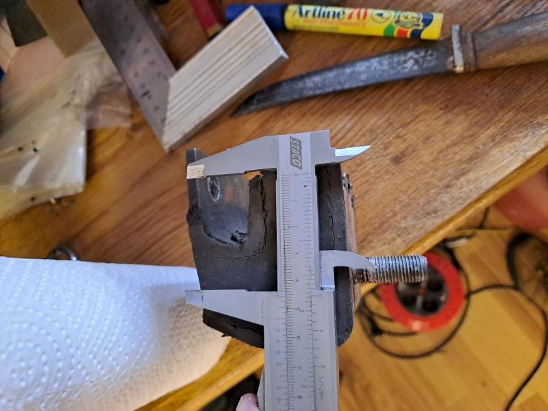

Can you put a tape measure to the two pictured motor mounts and give us a ‘height’ measurement?
By Krixo - Last Year
My original: The offset of the hole is 46 mm, the height is 66 mm
http://forums.y-blocksforever.com/uploads/images/e080e8bf-3877-44fb-8320-d81e.jpg
The westar EM-2110: offset 8 mm, height 75 mm
