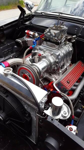

Is this the present engine?
http://forums.y-blocksforever.com/uploads/images/a9cd0cfe-5072-4eb5-a0f2-96ca.jpg

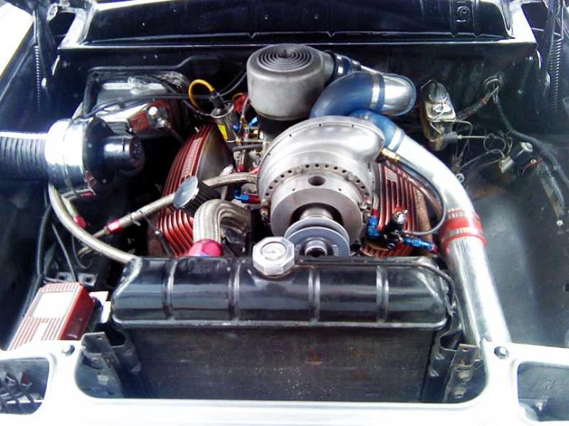

Non power. And that picture is when I had the McCullouch on it. I've gone to a 4-71 now.http://forums.y-blocksforever.com/uploads/images/e5907107-fb75-495d-a012-ab48.jpg
