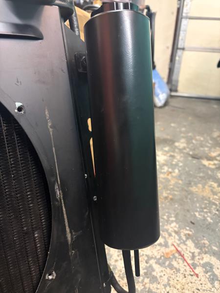

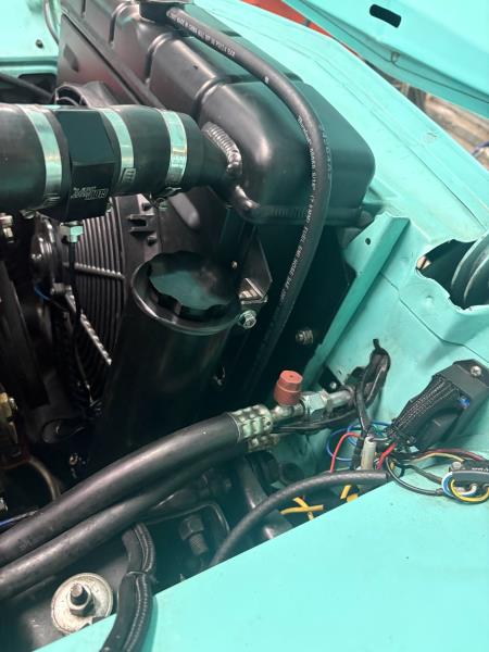

I ordered a black one, because I didn't want it to be too obvious. LOL   I happen to have my radiator in my 55 Tbird removed.   I believe this will clear the stock fan shroud.

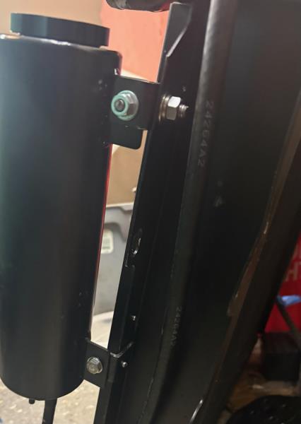

I used small "L" brackets, the top bracket uses the shroud mounting bolt.   There wasn't enough room to drill the radiator support for a lower bolt so I riveted the lower bracket to the rad support
http://forums.y-blocksforever.com/uploads/images/2ecd7517-a30f-4c06-a549-7415.jpg
http://forums.y-blocksforever.com/uploads/images/9d8a6d6c-690f-4641-b73c-9f95.jpg
http://forums.y-blocksforever.com/uploads/images/40f6af95-acac-45b0-a121-08ee.jpg
