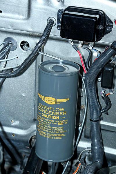

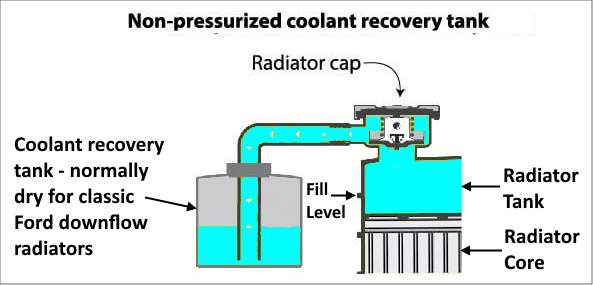

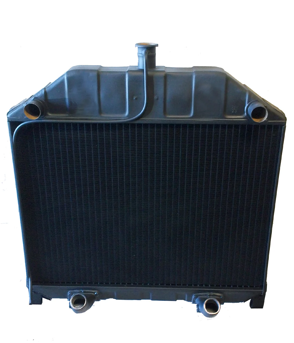

The top tank fill neck should have a tube running from it down the side of the radiator (pre-coolant recovery w/ outside container). When coolant expands (overfilled and hot), the cap releases the pressure and the coolant is released through that tube. When the internal pressure subsides to cap rated pressure the cap will close gain.

The style you have will bleed itself to proper coolant level over a few cycles if the system is tight and correct pressure cap). The nice thing about a COOLANT RECOVERY SYSTEM is it will bleed out most trapped air in the system resulting in having no air pockets trapped.

I actually took a good look at the radiator today, it was stored away. The inside is all rust orange and the slots to the core are pretty much closed up. It looks solid. Didn't see any real rust or rot. I called around to see about rodding and nobody wanted to work on it. Since there are quite a few fins bent flat, I'm thinking about an aluminum 3 core one. I believe the original one has 3 cores too. I found one that is for a mustang with the same dimensions, pretty much, as mine. Can also get it with shroud and electric fan for around $250. I found it earlier, don't have it handy to post on here at this time.
https://a.co/d/5m88cFu

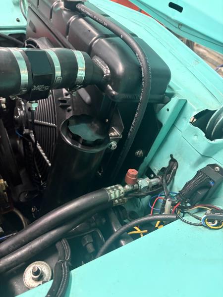

I think you & I have discussed the Casco kit before. I installed it on my 55 while it was still in my dad's possession. I wasn't happy with it & don't intend to use it, if I ever put my car back on the road. I have purchased US Radiator's 4-row, high-efficiency copper & brass radiator, Casco pump, Paragon WP spacer, 6-blade fan, small pulley, and 170-degree thermostat. I've also removed all of the rust & casting sand from the bare block. I don't intend to install a/c. If the weather is too hot for me, it will be too hot for the car.
By RossL - Last Year
I ordered a black one, because I didn't want it to be too obvious. LOL   I happen to have my radiator in my 55 Tbird removed.   I believe this will clear the stock fan shroud.
I used small "L" brackets, the top bracket uses the shroud mounting bolt.   There wasn't enough room to drill the radiator support for a lower bolt so I riveted the lower bracket to the rad support
