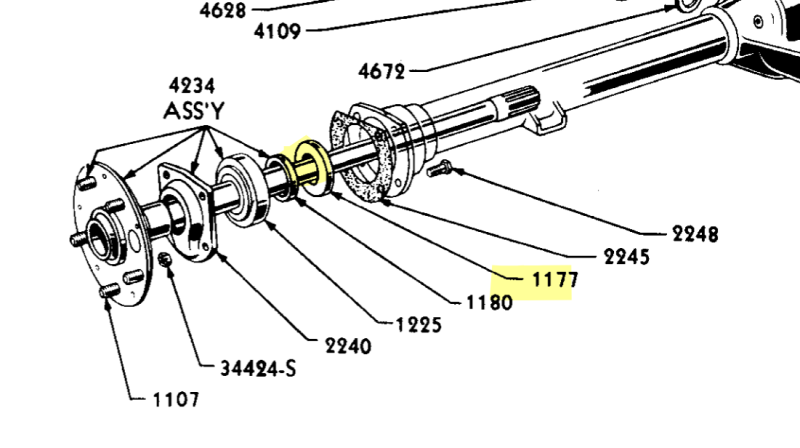

Looking at the diagram you posted on my other question I can't figure out which piece is the seal.

Basic Part Number 1177 in the ILL is the axle seal -

Posts: 1.8K, Visits: 306.4K
If the axle tube seal(s) are leaking, you will either see an oil residue or oil on the carrier plate (inside and/or outside), sometimes on the brake shoes themselves if leaking badly. You would also check the pinion seal as to sweating or leakage.
Make sure the housing vent is not clogged as this will also cause leakages.
There are special service tools to remove and install the end seals but you can cheat.
http://forums.y-blocksforever.com/uploads/images/14c8654c-2ebc-4a5b-b47d-775b.png
2240 is the retainer but also acts as an oil slinger/shield if the seal leaks.
