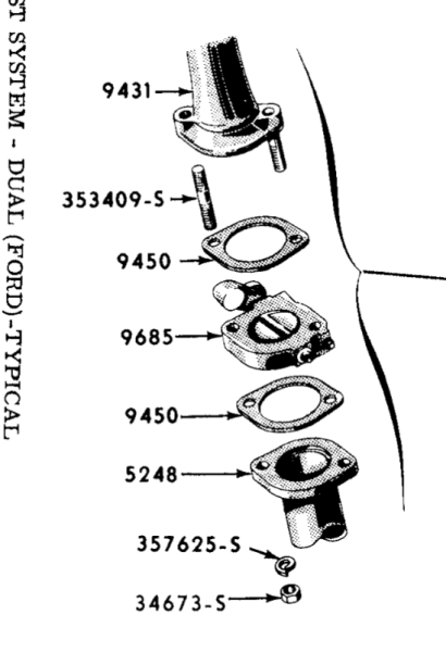

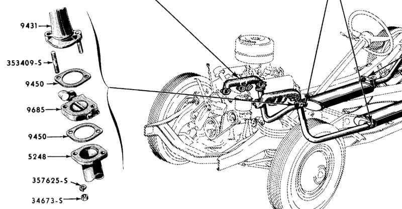

"I have a 56 Victoria with a 292 and dual exhaust. I have been putting up with a rattling noise from underneath and noticed that my exhaust pipe on the right side hangs down a little lower than the one on the other side because of the heat riser valve being on the right side. Because of this, the exhaust pipe is below center in the hole in the frame that it passes through causing it to rub and rattle."
The valve should be on the LS of the car if factory dual exhaust assembly.
Did the car come from the factory with dual exhaust, or was it converted from single at some point? If not the original inlet pipe (muffler shop replacement), it may not be correct in drop length. Are the exhaust manifolds (esp LS) correct (may be later year if a dual upgrade).

Looks like from your picture that I have been running mine on the wrong side. Mine is currently on the passenger side which might explain the low hanging exhaust pipe. I wonder what I have hurt by running it this way. My car had the thunderbird V/8 option and still has the original manifolds. Exhaust and tail pipes are stainless and were ordered from Concours years ago.

OK, hold on a minute ...
I re-checked cataloging and there are two ILL's for DUAL EXHAUST. One ILL reads 1955/56 FORD DUAL 'TYPICAL' and is the one I posted showing valve install on the LS. A few pages down, another ILL is shown titled 1956 FAIRLANE 'DUAL EXHAUST'  and shows the valve on the RS.
So that is my mistake. Your install appears correct.
