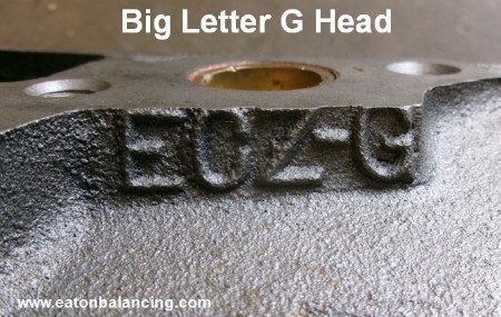

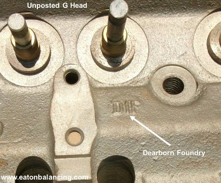

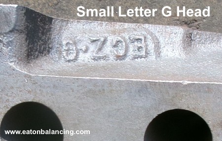

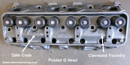

Great question but answers will be somewhat vague or ambiguous simply due to the number of variables involved.  The unposted ‘G’ cylinder heads have unsupported decks within them where the head gasket sealing ring resides.  This increases the chances for a head gasket failure should there be any flex in those head decks.  From the Ford shop manual, it was recommended to hold any milling of the 1957 heads to a maximum of 0.010”.  In doing that to a 312 with the ’57 camshaft, that makes the static compression ratio ~9.25:1 and the dynamic compression ratio ~7.85:1.  You can consider those your factory safe limits.
It must be remembered that FYB cylinder heads prior to the ‘G’ heads also had non-posted heads but those heads are not as susceptible to excessive deck cutting as the ‘G’ heads are.  The reason for that is the earlier heads, take the ECZ-C as an example, had lower intake ports that were cast as part of the decks thus adding a significant amount of support to the deck portion of the head.  The ‘G’ heads had lower intake ports that were raised and subsequently had a gap in the casting between the lower port and the deck internally.
All the heads cast at the Dearborn facility are of the unposted variety.  Late in the 1957 production run, the Cleveland facility started casting the G heads with the posts cast within them.  Earlier Cleveland heads are also unposted.  May 15th, 1957 comes to mind as the date that change at the Cleveland foundry took place but feel free to correct that if you have better information.  As a general rule, all small letter G heads are unposted but when dealing with the large letter G heads, you will need to verify if the heads are posted or not.
