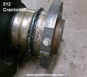

While the presence of the aspirin sized dot on the flywheel flange is a positive identifier for a 312 crankshaft, not having that dot can also be a 312 crankshaft.  Here’s a pic of the aspirin size dot.
http://forums.y-blocksforever.com/uploads/images/2ade9651-9a34-457c-b242-dfc5.jpg

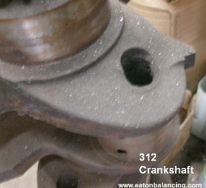

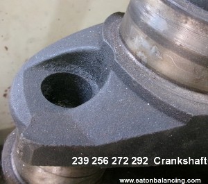

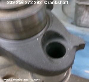

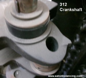

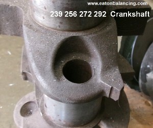

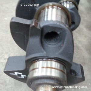

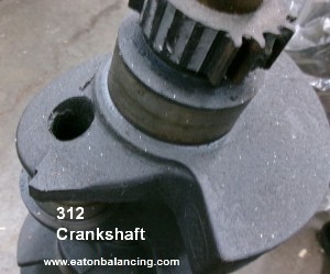

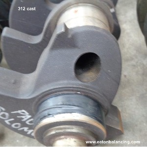

If no dot on the flywheel flange, then look for a casting identifier (EC, ECZ, MB, EBU, ECZ) on the outer edge of one of the end crankshaft counterweights.  EC would be 272 or 292, MB or EBU would be 239 & 256, and ECZ would be 312.  If those are not readable or not present, then look at the casting at front rod throw right behind the #1 main.  Smooth without any kind of cutout around the ‘lightening hole’ in the front journal, then it’s a 312.  If there is a cutout or ‘dip’ present around that hole, then it’s a 239, 256, 272, or 292 crankshaft.  Here are some pictures for more clarification.
http://forums.y-blocksforever.com/uploads/images/ed3115dd-3c44-47c6-a57f-c7eb.jpg  http://forums.y-blocksforever.com/uploads/images/ba9d97a3-cb0a-4e34-84da-c6ba.jpg
http://forums.y-blocksforever.com/uploads/images/b90c96c2-0c48-471e-af8f-9027.jpg  http://forums.y-blocksforever.com/uploads/images/1a08d065-65af-4c0f-a686-1417.jpg
http://forums.y-blocksforever.com/uploads/images/6e324b48-ad07-4908-97bf-7814.jpg  http://forums.y-blocksforever.com/uploads/images/86408e6a-187c-4c8f-bb2d-579c.jpg

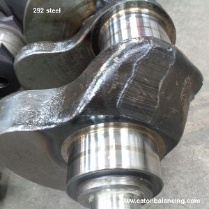

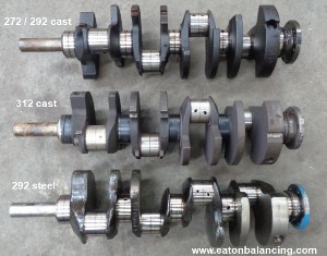

Additional pictures.
http://forums.y-blocksforever.com/uploads/images/e2cb8012-e03b-4abd-b88e-fc21.jpg
The cast cranks have eight counterweights while the steel crankshafts (292 only) have six counterweights.
http://forums.y-blocksforever.com/uploads/images/7510de88-c601-485a-93c0-24d1.jpg
http://forums.y-blocksforever.com/uploads/images/7848f50f-ecba-445e-99f8-0df3.jpg
http://forums.y-blocksforever.com/uploads/images/dcebefc1-bfa1-46bd-8dc1-8910.jpg
