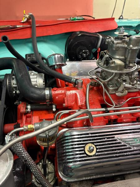

Yes it's a 55 TBird.   It's not overheating, it's vapor locking.   The vapor lock seems to follow the temperature gauge once it gets over 200 degrees (not sure of exact temp).   I am using an after market CASCO gauge and sender
I've been through the entire fuel system multiple times and I am fairly confident it's caused by heat.   I'm in located NJ drove the car last year in 95 degree weather with the AC on without any issues.
http://forums.y-blocksforever.com/uploads/images/6d7c975a-c11f-4970-9946-f489.jpg
