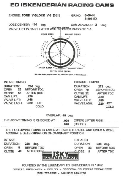

With all that said,  This is a cam that Ted recommends, you can see (if I loaded it correctly) that the Isky came opens the exhaust 10* sooner and the intake 4* sooner. This is my concern and I'm thinking about swapping it while the motor is still on the stand and I can roll it over.

1946international (11/28/2023)
...With all that said,  This is a cam that Ted recommends, you can see (if I loaded it correctly) that the Isky came opens the exhaust 10* sooner and the intake 4* sooner. This is my concern and I'm thinking about swapping it while the motor is still on the stand and I can roll it over.
To accurately compare the camshafts, the advertised duration numbers are also required.  Looking at just the 0.050” values does not give an accurate picture of how the lifter is beginning its initial rise on the lobes and the decline off the lobes.  The advertised camshaft numbers are typically at 0.020” lifter rise for a solid lifter camshaft. The 0.020" values are used for dynamic compression ratio calculations as well as giving a snapshot of what the lobe ramps look like at the start and end of the lifter travel when comparing the 0.020” and the 0.050” values against each other.
As Joe mentions, there have been a number of quality issues with the Comp Cams grinds.  Top of the list are the lobes being ground on the wrong lifter bank angles and second on the list is the variability of the lobes in regard to the camshaft lobes being ground the same for all the cylinders.  When degreeing in the camshaft, always check both the intake and exhaust lobes on at least one cylinder on each bank to ensure that the camshaft is ground the same for both banks.  Cylinders 1 & 6 both share the same TDC on the degree wheel so it’s just a matter of moving the dial indicator to do that.  Any variability in those two cylinders will suggest that the camshaft was ground with the incorrect lifter bank angle.  If variability is found, then it may be necessary to check all sixteen lobes for verification of that.
