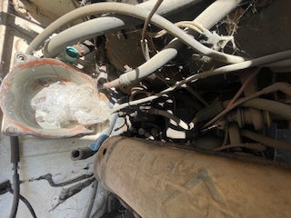

I'm also working on a '54 Lincoln w/317ci and have similar dual exhaust aspirations. The driver's side is the challenge.
Hopefully these recent pics I took a '55 Lincoln's driver side factory install help you. The quality of the first pic is poor and rotated 90 degrees CCW (engine is at the bottom of the pic), but zooming in you'll see an exhaust flange protruding from the inner fender. The exhaust header's discharge port faces towards this inner fender flange. A small 4"-5" pipe must interconnect the header to that inner fender flange but unfortunately it was missing from the car. The small pipe is routed well above the steering box and transmission linkages but rests below the Treadle-Vac (which was missing and stuffed with a plastic bag).
http://forums.y-blocksforever.com/uploads/images/49b35af0-b07f-430e-bc80-53b8.jpg
  http://forums.y-blocksforever.com/uploads/images/23197b6b-c2e0-4278-8dfa-af92.jpghttp://forums.y-blocksforever.com/uploads/images/27871f60-f1b8-4931-924f-af56.jpghttp://forums.y-blocksforever.com/uploads/images/e3c4b354-a8a9-4ab7-a5b5-d8b8.jpghttp://forums.y-blocksforever.com/uploads/images/4e75979d-fea4-47b0-a72b-6834.jpghttp://forums.y-blocksforever.com/uploads/images/4b69a6bb-33fe-4704-a210-1baf.jpghttp://forums.y-blocksforever.com/uploads/images/08d107a1-53c1-4864-8575-0a0c.jpg
