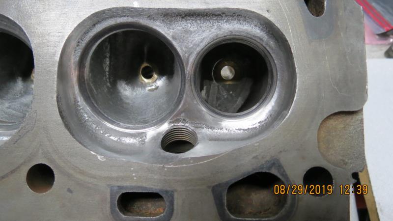

If you have six inch carbides in diamond oval, or flame shapes that are 7/16" or 1/2" diameter, then clean up the entire ports from valve seat to intake manifold.  Match the intake to a Fel Pro gasket size and clean up around the valve guides so that you end up with a taper to the stem.  The valves should not hit the cylinder at less than .535" lift, and you may get by with more with the 1.94" valve.  The exhaust valve is not an issue.  On the pushrod wall, work that down a bit, and the cylinder head bolt wall.  A good multi-angle valve job and you should be close to your goal.  Work the tops and sides of the ports more than the floor. I personally use stones on 3 1/2" mandrels in various sizes to get a better radius around the guide, pushrod tube wall, and cylinder head wall.  Those are hard to find but work really well on iron heads.  The exhaust port just needs a clean-up and square it to the gasket size.  Don't try to take down the guide area very much, or you will find water.  A radius valve job on the exhaust with a 45* seat angle works well for street duty.  I would not worry too much about the combustion chamber at your performance goal.  210 cfm is easy, but 150+ is not.  Nature of the head.  Joe-JDC

Thanks for the photos. I see you used Beehive springs. I will use Pac 1283 Viper Beehive springs. They are Beehives that are closest to cam manufacturer's recommended installed height and seat/open pressures. I realize that the heads will have to be cut for same.
