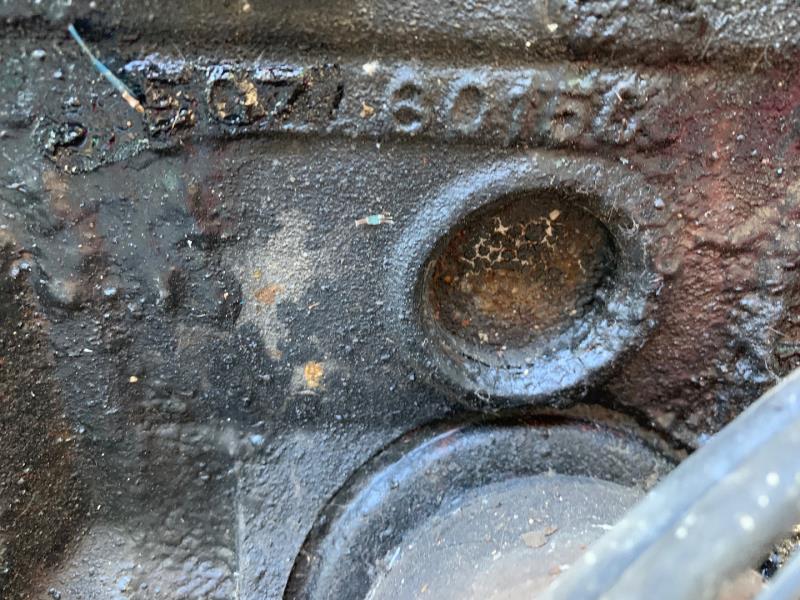

Posted 4 Years Ago
Supercharged (114 reputation)Supercharged (114 reputation)Supercharged (114 reputation)Supercharged (114 reputation)Supercharged (114 reputation)Supercharged (114 reputation)Supercharged (114 reputation)Supercharged (114 reputation)Supercharged (114 reputation)
Last Active: 3 Months Ago
Posts: 45, Visits: 5.1K
Ok, here are some pics of the engine. Carb-replaced at some point with a Ford something 4 bbl. No sludge in the valves galley, and the block is still full of antifreeze. I am going to be optimistic and hope the engine still has life left in it. Hey-one can hope. I will try and verify the 312 next weekend when I get a chance to pull the tranny off.http://forums.y-blocksforever.com/uploads/images/035f10bc-1b5f-416f-9a30-ade2.jpg
.http://forums.y-blocksforever.com/uploads/images/67ae3715-e426-4599-aad2-abf1.jpghttp://forums.y-blocksforever.com/uploads/images/3a86d3c4-acc5-4480-908b-426a.jpg

I just verified the little Aspirin on the crank flange! She also rotates and the starter looks good to go.
