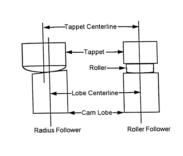

This is from the Crane Flat Tappet Break-in Procedure:
"Due to the EPA’s mandate for zinc removal from most motor oils, proper flat tappet camshaft break-in procedure is more critical than ever before. This is true for both hydraulic and mechanical flat tappet camshafts. As a point of interest, the most critical time in the life of a flat tappet camshaft is the first 20 minutes of “break-in” during which the bottoms of the tappets “mate-in” with the cam lobes.
The cam lobe and lifter base depends upon splash lubrication here.
There are some oils with additive packages that are better for camshaft “break-in”. These include: Shell Rotella T oil; Chevron Delo 400; and Mobil DELVAC oil. These oils are listed as diesel oils, but work great for flat camshaft “break-in”. We also recommend the use of Crane Cams # 99003-1 Break-in lube or GM “E.O.S.” (Engine Oil Supplement) Assembly Lubricant # 1052367. These should be poured over the lifters and camshaft prior to start up.
They are both diesel and gasoline rated engine oils (API Classification). Cam assembly lube (and there are debates concerning different manufacturers quality also) must be generously spread on the lobes and tappet faces. This is the only lubrication they will receive until the designed oil splash commences. Once lubed in this fashion, it is imperative the engine not be turned and is able to quick start to not lose the lubricant from the surfaces.
Synthetic is not to be used for break-in and as previously noted, may not be feasible for proper tappet rotation on the cam lobes if used as a long-time lubricant (synthetics also do not have the zinc additives as they have been removed also).
