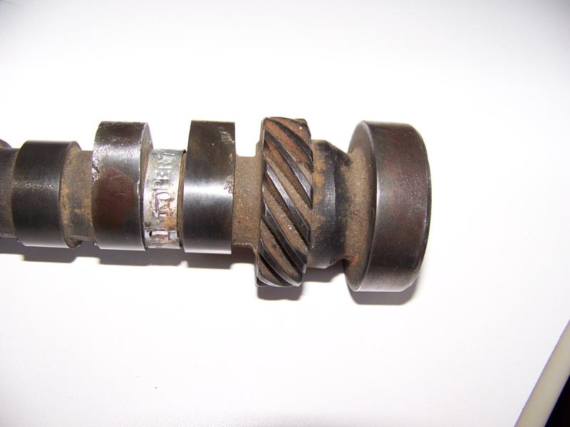

Hi guys, this is a broken camshaft that came out of a 1957 D/F car what was used for drag racing, the engine broke a rod in 1957 I have no idea what it maybe, it is not mine, it belongs to the man I bought a lot of blower stuff from a long time ago, he wants to keep the cam, but here are some pictures.http://forums.y-blocksforever.com/uploads/images/9b0fcf8c-9bcb-4cec-8cf2-788e.jpghttp://forums.y-blocksforever.com/uploads/images/1c55152b-d568-4105-99ba-eb32.jpghttp://forums.y-blocksforever.com/uploads/images/153743e4-64e7-4a26-9e46-9c47.jpghttp://forums.y-blocksforever.com/uploads/images/6b2985f8-476f-4a3c-9803-9d55.jpghttp://forums.y-blocksforever.com/uploads/images/e73c52a1-e87e-4032-b9b2-154b.jpghttp://forums.y-blocksforever.com/uploads/images/0164855c-8438-41e8-b8d6-1003.jpghttp://forums.y-blocksforever.com/uploads/images/002b1416-ff13-4c4c-b1d9-b60e.jpg

Cliff
Is the cam the original cam that the engine came with?
The logo appears to be  Harman & Collins.
Can you measure the lift ?
Thanks,Oldmics
Cliff
Posted 5 Years Ago
Posts: 878, Visits: 13.5K
Don't know, looks like intake lobe lift .285, exhaust .280 (with a caliper) I know this was a phase 1 car and was bought to race from Maywood Bell Ford in 12/1956
