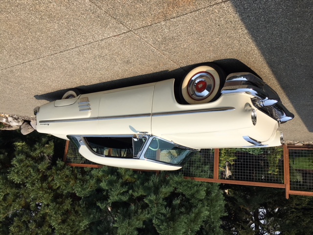

This is going in my 54 Merc Monterey. The car is already done, I just thought it would be cool to have an all Mercury car. We just made an engine stand so we can run the 368 once it's done before installation and fix any bugs before install. I'll post more pictures as we go along.  Spent a couple of hours today sanding down a pair of ram horn exhaust manifolds before sending them to the coaters. I have about three pairs of Lincoln exhausts if anyone is interested. Also a power steering pump.  I'm sanding down the water pump and timing chain cover also.

A lot has to do with where you are standing when you take the picture.  You need to think ahead of time where you want "up" to be in the picture.  Joe-JDC

It's either the browser or site. When I hit to enlarge, it shows correctly (FIREFOX).
I have occasional troubles here but believe it is my browser.
