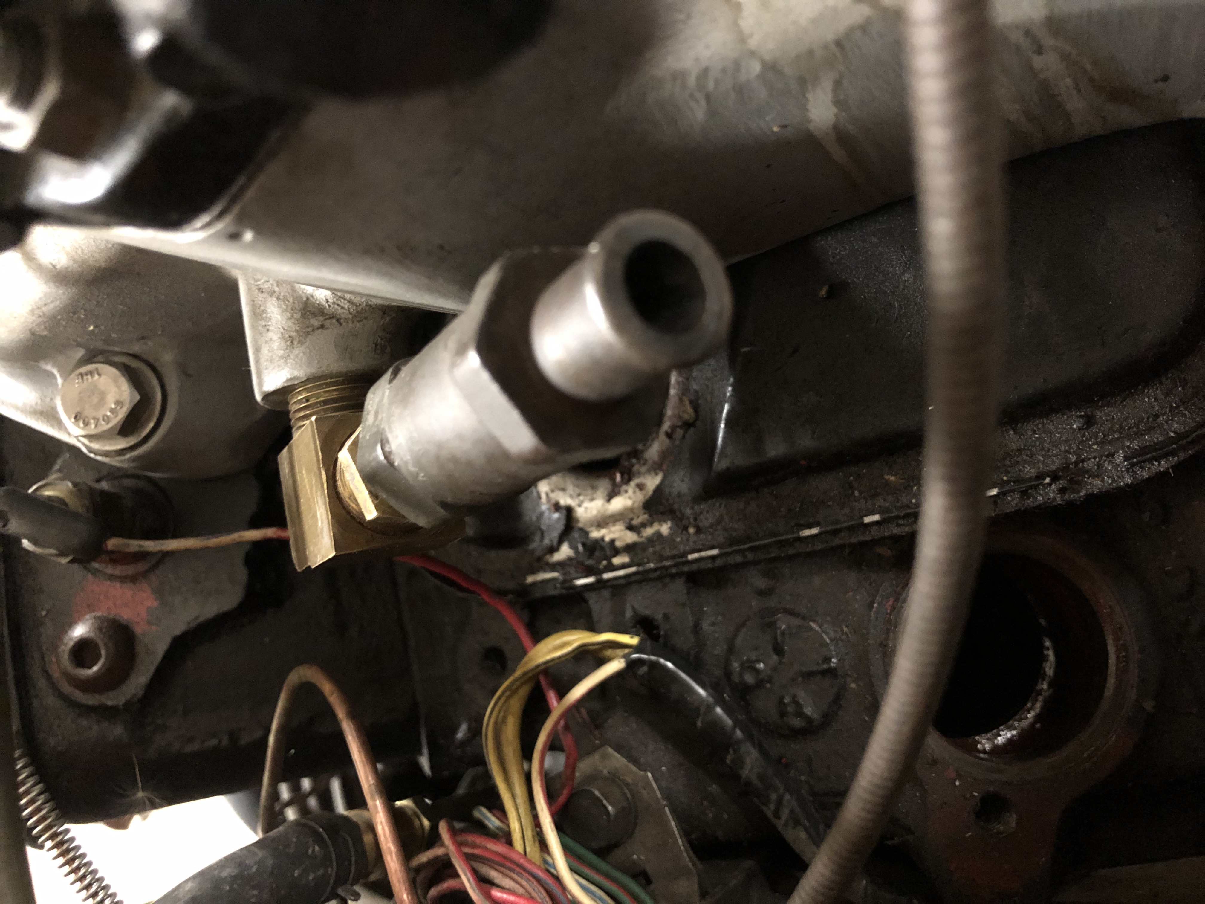

This is what I had to do for the breather rear PVC part used from 61-64 to work with a dual quad 257 Edelbrock manifold.

I will try one more time to post pictures of how I ran my tri-power PCV valve on an Edelbrock intake.
