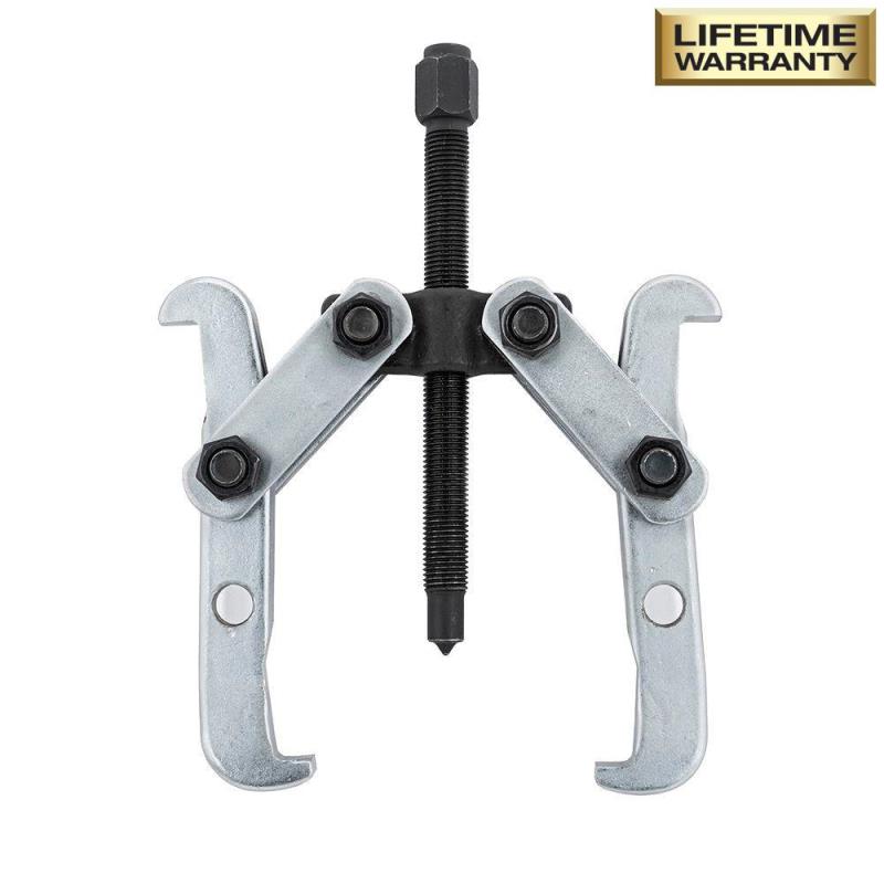

I ditto Kultulz. In 100% of the Y blocks I have disassembled I had to use the exact same puller for the cam timing gear. The crank gear was always more loose and slid on its snout.

http://forums.y-blocksforever.com/uploads/images/5e3412c5-c855-4072-871d-3ccb.jpg
