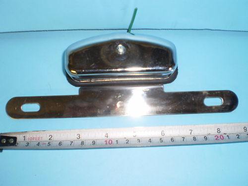

.A friend of mine had the same situation with a 55 Bird (aftermarket continental kit).  We did the same thing as you are thinking about doing.  It.worked very well
For the light, we used something similar to this
http://forums.y-blocksforever.com/uploads/images/a6a67584-c7f6-43fa-9935-78c5.jpg
I saw this on ebay, interesting light
http://forums.y-blocksforever.com/uploads/images/5965e325-9d52-4bc4-a455-ce96.jpg
Look on ebay for hot rod license plate light or license plate light.  Lot of options
