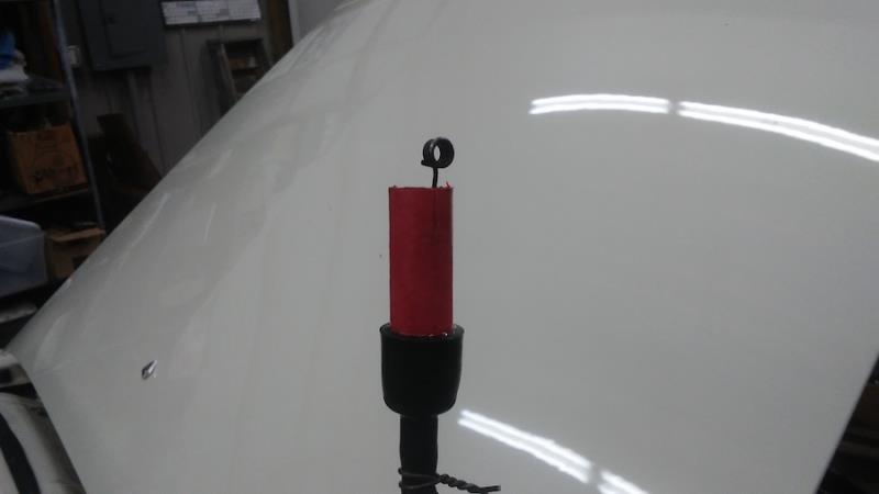

Both the cables on my car were stuck solid. I took them loose at the end under the hood. It is a little tight but you can do it. I used a coil wire boot as a funnel by slipping the small end over the end of the control cable and securing it with a wire tie. Mix a 50/50 solution of automatic transmission oil and acetone or lacquer thinner. Prop the cable in a vertical position and fill the boot with the mixture. Occasionally check the level of the mixture and refill as necessary. Place rags in the car to avoid dripping on your carpet. The oil mixture will travel down the cable and eventually run out at the knob on the dash. Push/pull the knob in the car occasionally to see when it releases.
