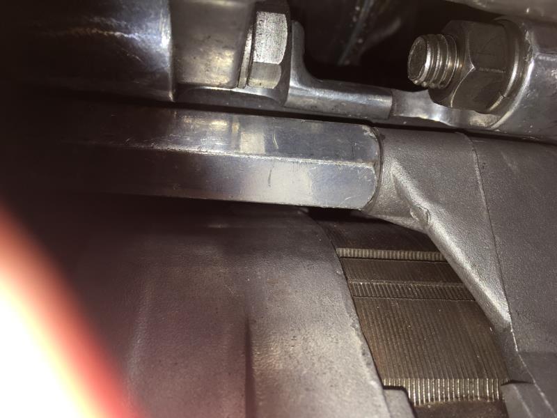

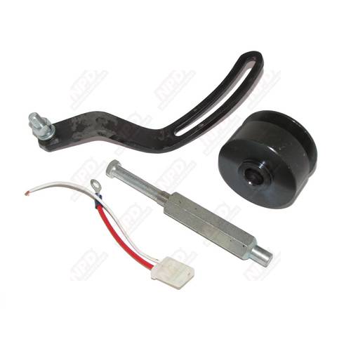

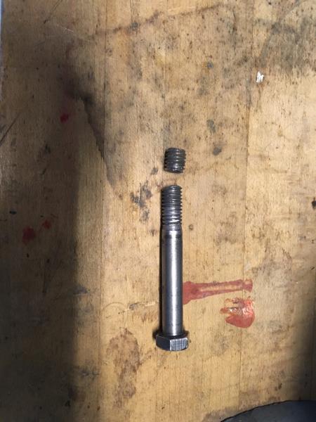

                I’ve had a couple of these “kits” to put an alternator on the oem generator bracket.  One from a ‘bird supplier, and one from the Classic air company.  I pulled the bird out of winter storage and went to check the a/c charge.  While I was setting up, I realized the alternator was wobbling all over.  Still charging.  I shut it down and went looking.  This is what I found on the front mounting bolt, which threads into the “coupler” style adapter to the rear mounting point.  This is an unrated stainless bolt, maybe something I substituted, or got changed, or who knows.  Because of the EFI, electric fans, wipers, and a/c, it’s a pretty heavy 90 amp alternator. At any rate, it’s got a grade 8 in it now.  Might be worth a look if you’re using something similar.  Pretty lucky to find it in the garage and not on the side of the road.

                What diameter is that bolt?  A stainless bolt should be quite strong.. How tight was it or how much torque was on it!

                It’s a 3/8-16 by 3” bolt.  It probably wasn’t over torqued as it tough to get to, and you can’t get much of a wrench on it.  It shows signs of crystallization at the break.  I think it was a combination of load and vibration.

                Ordinary stainless bolts are not that strong.  They do make a grade 8 equivalent  stainless through Totally Stainless although I don't know if available in your particular length.
