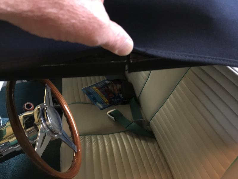

                I’ve got a late frame on a 55, also front holes, with the early style hold down handles in back.  If what you’re referring to on the top frame is what I think, mine’s the same way.  The weather strip shows it not quite closing.  I’ve had two sets of vinyl or fabric, both the same way.  You can just see it under my thumb.

                Ford added a link in the area of that pivot to help remove the sag on the '56 and '57 tops.  The tension on the two straps running from the rear bow to the front bow needs to be sufficient to help support the top also.  The '55 tops were never the best anyway.

                I think the hinge sag is for 2reasons.     Im in the rear hole (wrong) and it is pulling the top to the rear, secondly the hinge sag is excessive anyway.  Thanks for your reply.
