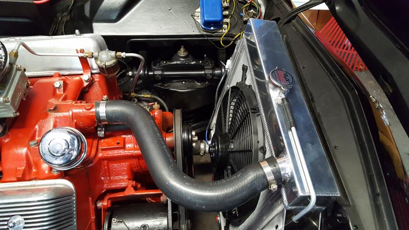

My 55 TBird ran hot idling in traffic.  I replaced the stock radiator with a three row Champion aluminum radiator.  I also removed the stock fan and installed an electric fan in it's place.   The whole package cost me less than $350.   Now I don't have to hear the old "wind mill" fan and my car runs 170 degrees in hot Florida weather.  Best upgrade I ever did.http://forums.y-blocksforever.com/uploads/images/4c8d20ff-1caa-42bc-8ade-45e9.jpg
