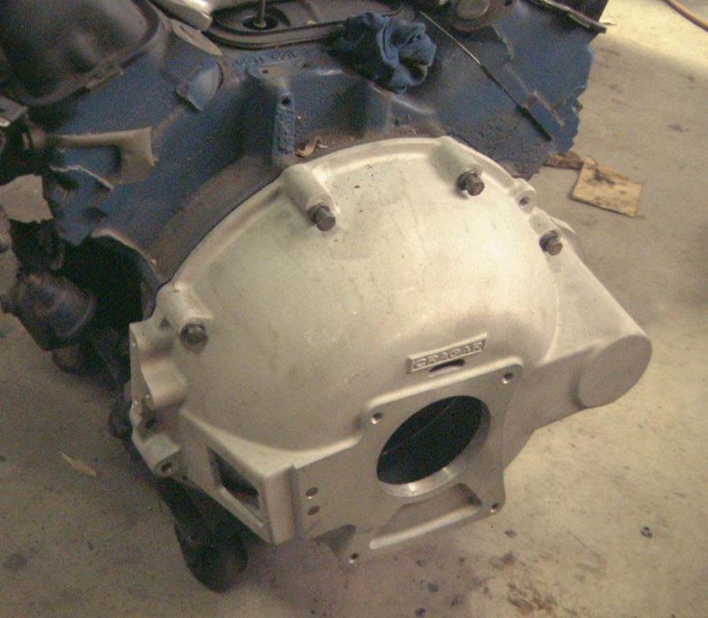

The 1957 MERC Monterey 368CI M-335 Engine came through with a M/T.
The bell was cast and supplied by CRAGAR.
The truck LYB (279-317-302-332) are heavy and clumsy.
http://forums.y-blocksforever.com/uploads/images/be4acfbc-d1b1-4258-ba1e-ab75.jpg
CRAGAR also sold the bell aftermarket with CRAGAR cast on it.
