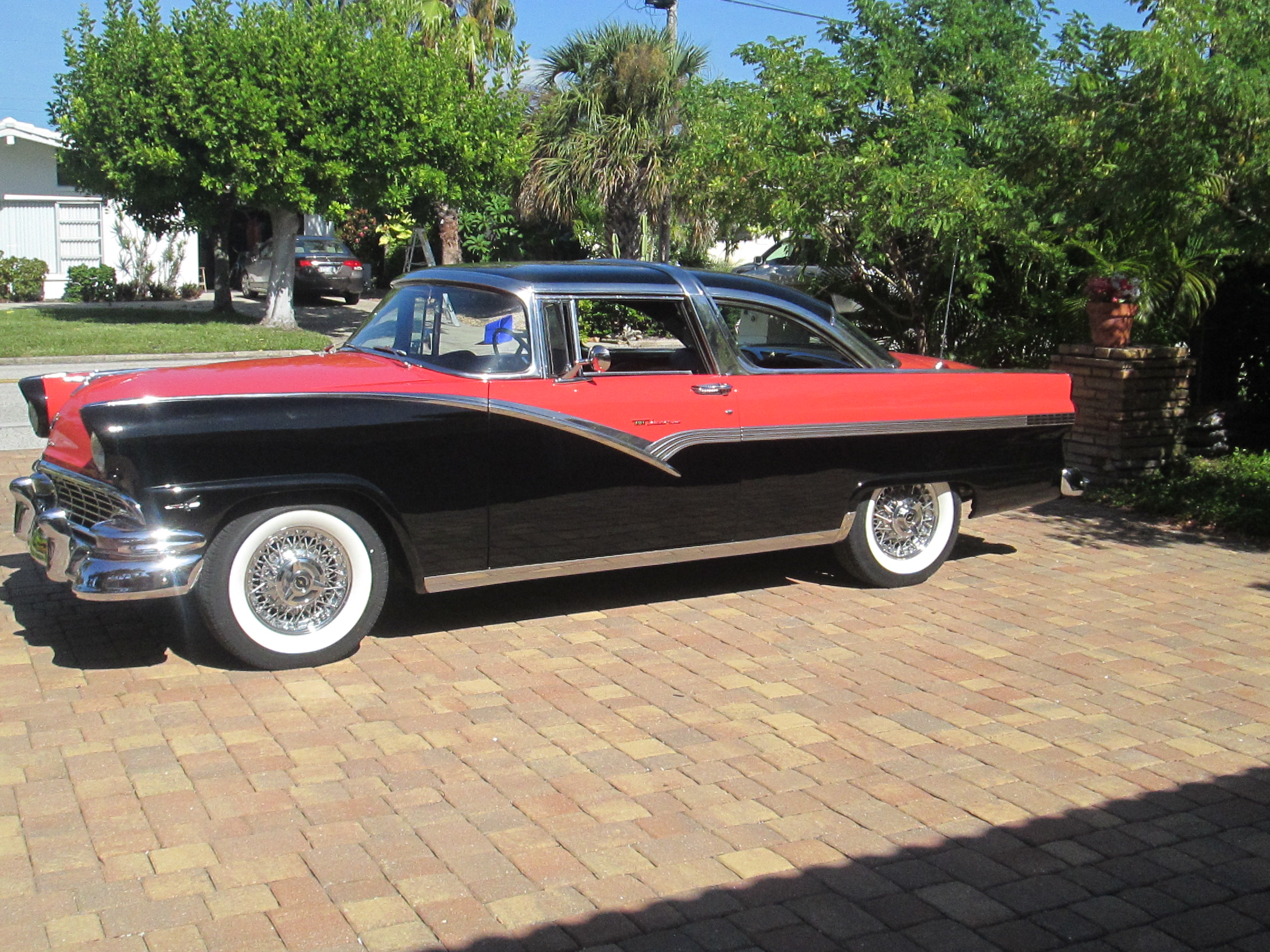

                Joe, Here is my '56 Crown Victoria that the Y-block 327.07 sits in. It is 3 speed w/overdrive, electronic ignition and 500 cfm carb. Manual steering a brakes, Coker wide whites and Kelsey Hayes rims. FUN, FUN, FUN Once again, THANKS, Tim Quinn

                Tim are those tubeless radials or tubes on those wire wheels? Gary
