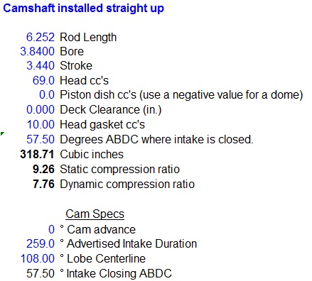

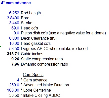

Butch.  In looking at your open/close specs, they are for the cam timing as measured at 0.050” lobe lifts and not at 0.020”.  In running the calculation for the intake closing at 0.020” with a 259° advertised duration, I get 53½° ABDC.  That’s with the camshaft installed 4° advanced.  With the camshaft installed straight up or at 108° intake lobe centerline, I get the intake closing event occurring at 57½° ABDC.
Here are the SCR and DCR values with your camshaft with the lash set at 0.020” and assuming the heads have 69cc combustion chambers.  Both the 4° advance and straight up numbers are posted to give you an idea of what happens with the DCR as the camshaft is moved around.
http://forums.y-blocksforever.com/uploads/images/d0dbcf1c-4bec-43ad-9b87-3a4c.jpg
http://forums.y-blocksforever.com/uploads/images/e2ea89c5-bf4f-495f-ab1f-e166.jpg

Thanks Ted and Charlie for your help.  I'm hoping this makes a good torquey, pump gas friendly, engine.
