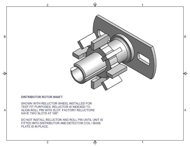

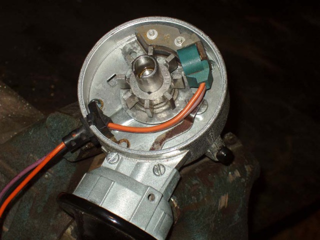

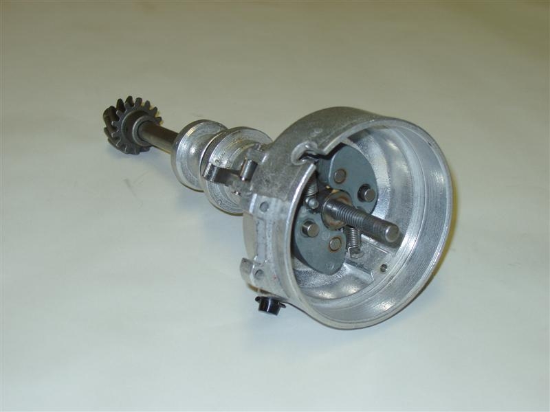

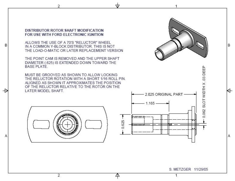

i was told the pickup coil is bad, but a gm 1 will fit. the 1 i bought  i resold  at a swap meet. I have converted 3 57 and late r block diist. to ford dura spark with great success. you need patience and some teck smarts. only issue is i can't find a source for cent force weight  plastick bushings. any help would be great. if any 1 wants i have a wiring diagram. for best results you need a dura spark coil as well

That is a Load-O-Matic distributor, which will only work with the carburetor it was designed for.  If you do not have an original or if you want to use a modern carb, you must use a distributor for '57 or newer.
Even if you do have the original carb and no plan to upgrade, the newer distributor is a better choice.
