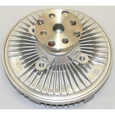

Hayden makes a fan clutch that fits well on the T-bird - due to the extra space ahead of the engine. Hayden #2797

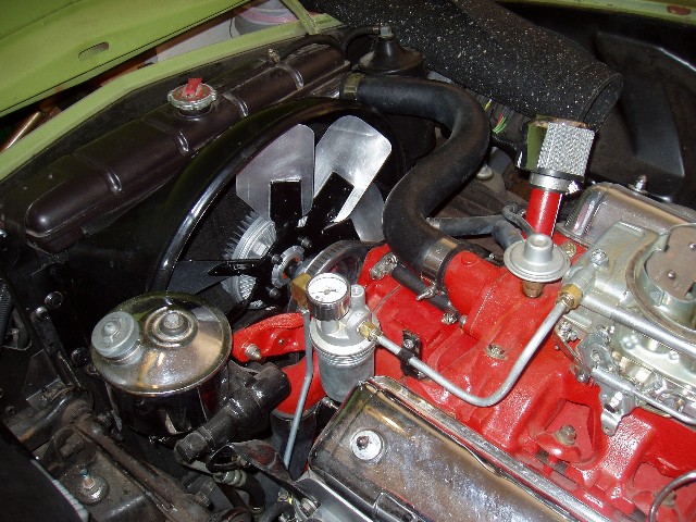

Make sure your fan blades clear the shroud correctly. This is an aluminum 7 blade from a GTO - but a six blade will do the job.

Mine is an aluminum 7 blade cut down to 18 inches. Halfway out of the shroud is a decent target to shoot for. As far as the Hayden clutches go the Heavy Duty (p/n 2747) and the Severe Duty (p/n 2797) both fit - the 2747 requires a little sleeve / spacer to decrease the pilot fit to 5/8's. The Severe Duty is the best choice in my opinion - it has a much larger clutch area and the pilot is direct fit for the 'Bird.

Just be sure to take a good look at the "pitch" of the blades of fan you choose - they differ. The viscous clutch style fan drive loses about 10% of the rpm available due to slippage. If your hot idle is low - and you only get 90% speed - and the water pump speed is low as well - a "flat" fan can cause you a problem.
The one in my photo above is a Pontiac (GM) aluminum, 7 blade with a rather heavy pitch - cut down to size. Just one way of dealing with the problem ...... there are others.

Hey Steve. Do You have a Part # for that Fuel Filter you have on your's? Or an Original Application?
GREENBIRD56
Posts: 1.7K, Visits: 102.7K
Its an AC Delco GF62 - I don't know if this exact style is still around. At one time they were Corvette parts. The Ford branded canisters usually come from Mustang restoration outfits.
