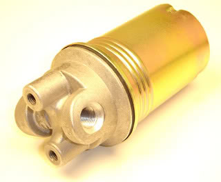

Hey Steve. Do You have a Part # for that Fuel Filter you have on your's? Or an Original Application?

Its an AC Delco GF62 - I don't know if this exact style is still around. At one time they were Corvette parts. The Ford branded canisters usually come from Mustang restoration outfits.

Thanks. Rock Auto has them. $31.00. Cheaper than the Ones on Ebay.
