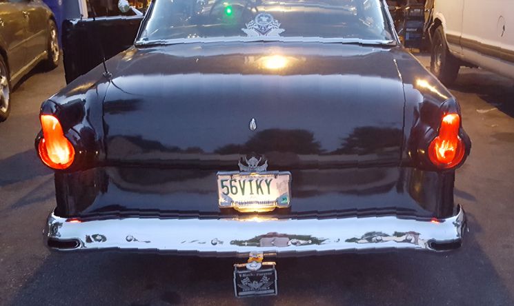

Miker, I'll take a look tomorrow for brand. I'm running two bulbs behind some of the fiberglass, single lens Mercury Station Wagon style lights. There is no room for a diffuser so you see the two bulbs. They have plenty of all around light but at a short distance are much more focused to the rear. I'll see if I can get a night shot of them too.
