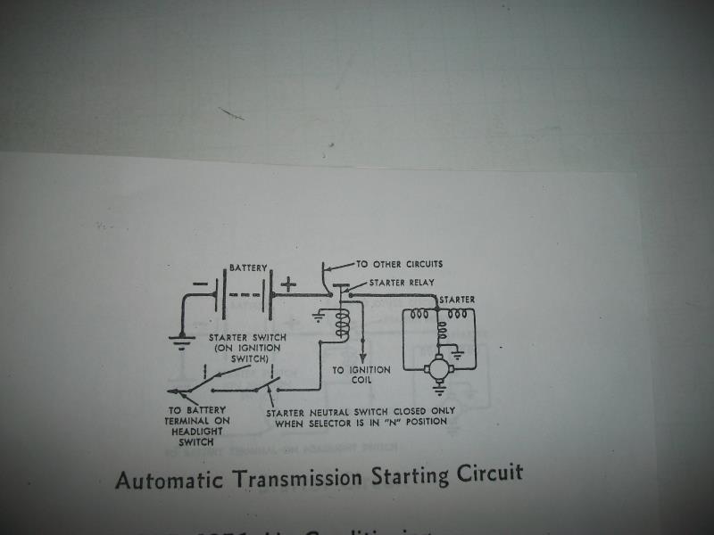

This Car is an Automatic. There is only One Power Source feeding the Neutral Switch which also activates the Backup Lights? Same as 55-56 Ford? The Backup Lights on mine work without turning anything else on including Ignition Switch or Headlight Switch. How is the 54 any different?
Posts: 3.7K, Visits: 32.4K
56Roger (10/1/2017)
Quote..." This Car is an Automatic. There is only One Power Source feeding the Neutral Switch which also activates the Backup Lights? Same as 55-56 Ford?"
That is how my 56 automatic is wired.
Quote..."One modification is to change the wiring so the back up lights would come on anytime it was put into reverse."
That's the simple solution to the problem. Just feed the power from a power source that comes on with the ignition switch instead of the light switch. That is what I heartily recommend. Drivers these days are looking for backup lights and know what they mean. That car is in reverse and about to move backwards if it isn't moving already.
This is one case where "keeping it all original" is not the greatest idea. Have to remember that in the 50s many things about automobiles were still getting figured out.
I just checked a Wiring Diagram for 56. Power to Neutral Switch does come from Headlight Switch BUThttp://forums.y-blocksforever.com/uploads/images/fdb72693-9c9d-4dbc-8e6f-6d9b.jpg i
 it is Battery Terminal on Switch. That Terminal is "Hot" all the Time. If Wire terminal to Neutral Switch is on One of the "switched" Terminals on Headlight by mistake it will only work when Headlight Switch is on. Use a Test Light to find the "Hot" Terminal with Switch off and move the Wire feeding Neutral Switch to that Terminal.
