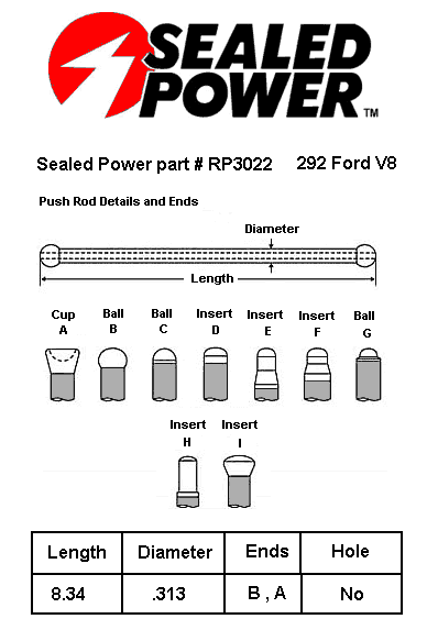

I have 16 nos Y-Block "Sealed Power" made in USA HD type push rods #RP-3022 , $45.00 including shipping. ....vehicleone@hotmail.com.

What length are the nos ones mine are 8.125
Lou
Posts: 558, Visits: 8.3K
8 1/8 overall.

I think the last ones I bought I got from Rock Auto...... were these RP3022. Charlie got some from a source and the pockets had some defect?????
